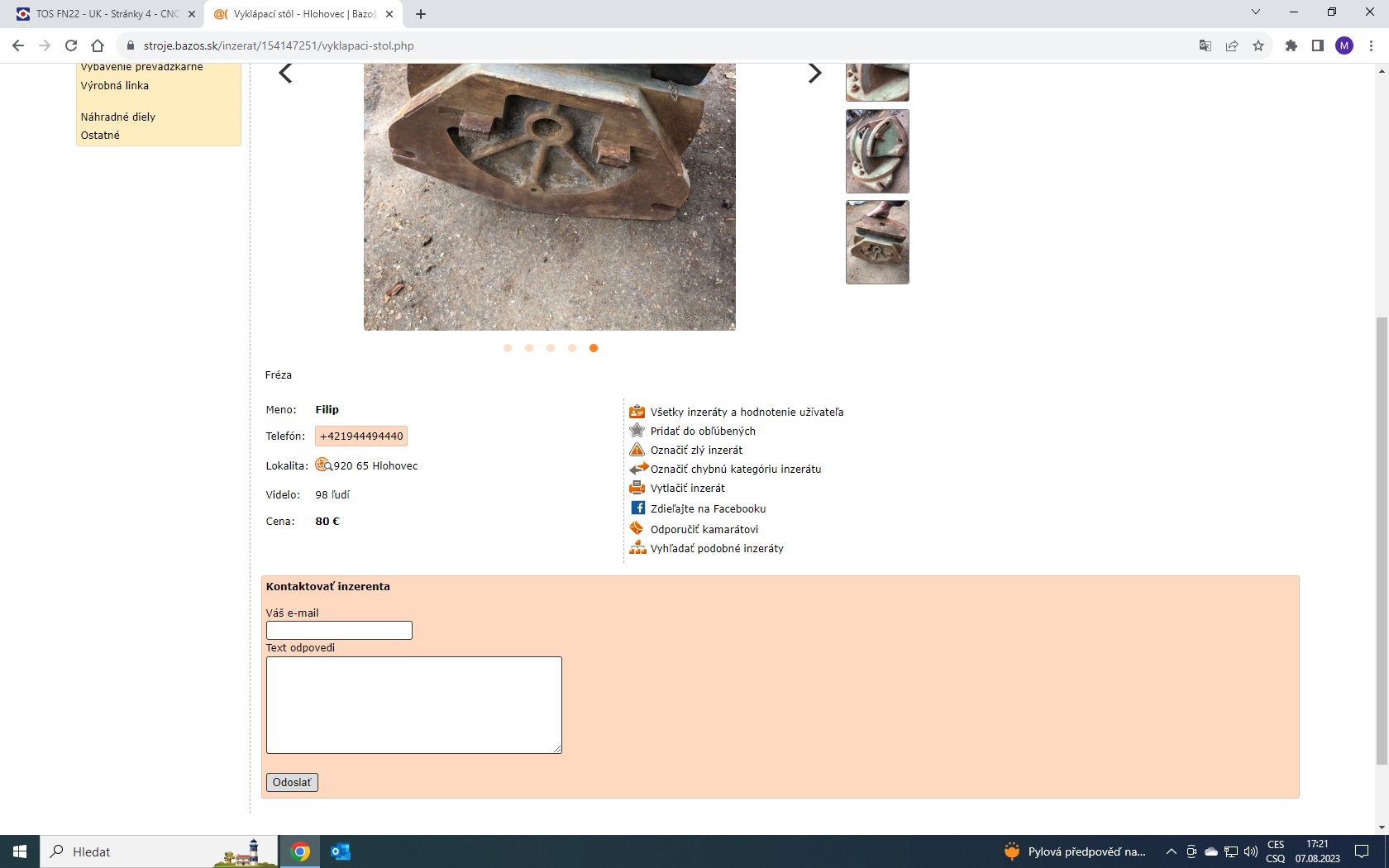

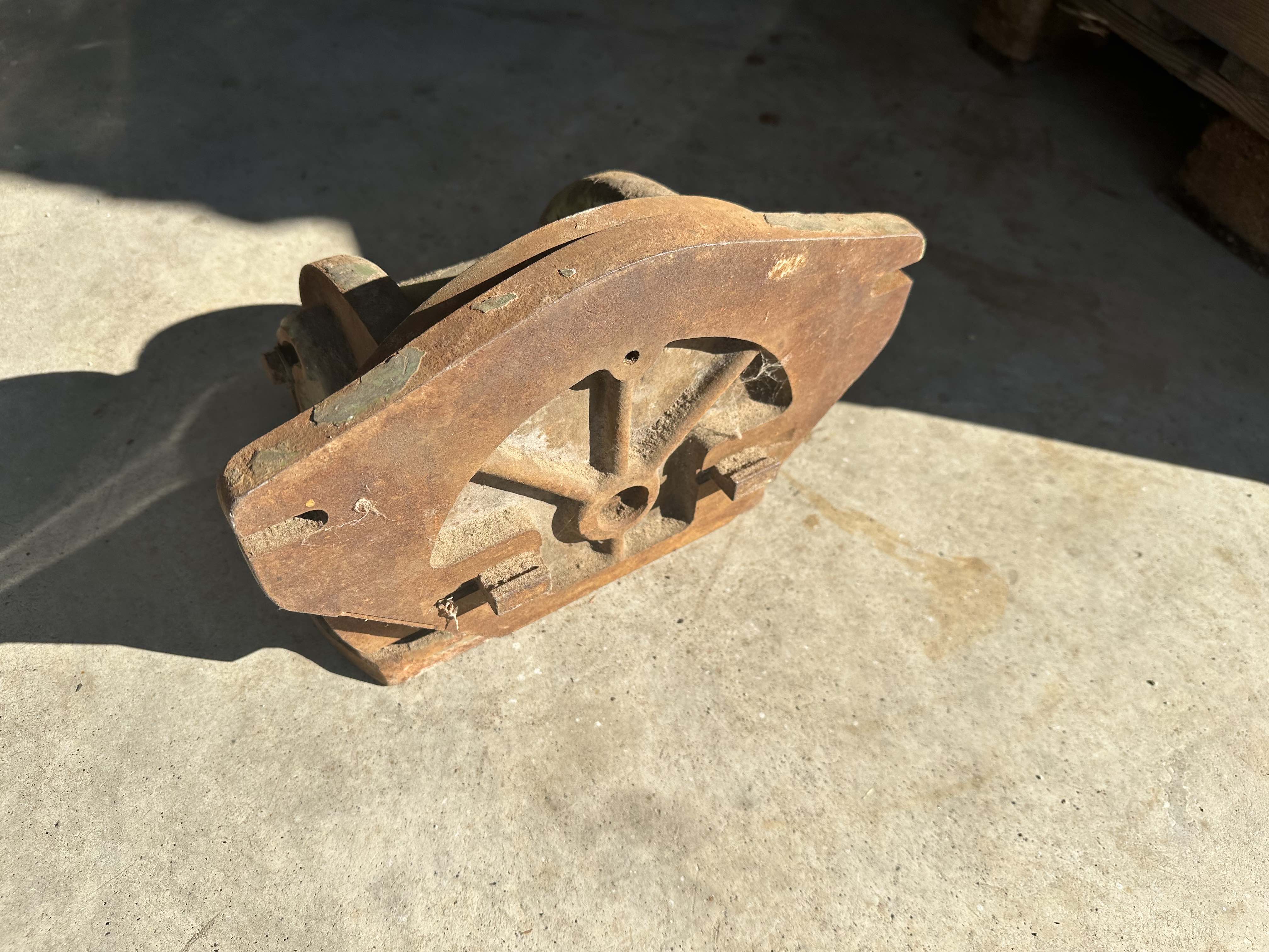

That is indeed the correct part. Thank you!
Would you be kind enough to send me his contact details? I cannot register with a UK phone number.
Příspěvky: 5255
7. 8. 2023, 4:21
Hi, the phone number is
Na hobíka to asi jde...

I have sent the seller a message on whatsapp. So far I have had no reply but I can wait. f he does not reply, or if he is unwilling to send the part to me in the UK, is there anyone who can step in and help with the process? Of course I would not expect anyone to handle the money and I would be willing to send a reward as thanks.
Příspěvky: 7216
8. 8. 2023, 6:20
Prosím, byl by někdo ze slovenských kolegů ochoten pro ten kus litiny do Hlohovce zajet, koupit a poslat to Peterovi do UK?
případně alespoň sem do ČR, třeba já bych mu to do UK poslal

Zavolam na ten inzerat a zistim. Vo stvrtok idem okolo, tak ak este bude k dispozicii tak to vezmem.

Hi Peter.
The part is available. I have an agreement with the seller and I will pick it up on Thursday.
In september, a nephew will come to Slovakia from London. If you were willing to pay for the luggage, maybe he can bring it to London. I hope that only that one part is enough for you, because the whole thing will be too heavy. We will agree more via private message.

Rado I don't know what to say except thank you very much. I will send you a private message to arrange the details.
Thank you also to testone for putting the mesage out there for me.

Hi Peter. The part is in my garage finally. Now the more difficult part. Find a way to get it to your house :)
Páni kolegovia poraďte. Okrem toho, že skúsim to zabaliť do kufra synovcovi napadlo ma to poslať po nejakom dopravcovi čo robí pravidelne Slovensko (Česko) - Anglicko. Nepoznáte niekoho?
A ešte k tej preprave lietadlom. Myslíte že to bude v pohode? Ak to uvidia pod röntgenom, dúfam že nespôsobí nejaký bezpečnostný incident...

myslím že pokud to bude zabaleno a odbaveno jako zavazdlo do zavazadlového prostoru (ne do kabiny!! ) tak jediné co je bude zajímat je hmotnost kvůli zaplacení

Podívej se na https://www.zaslat.cz/ mají tam UK tak by to mohlo jít kamionem.

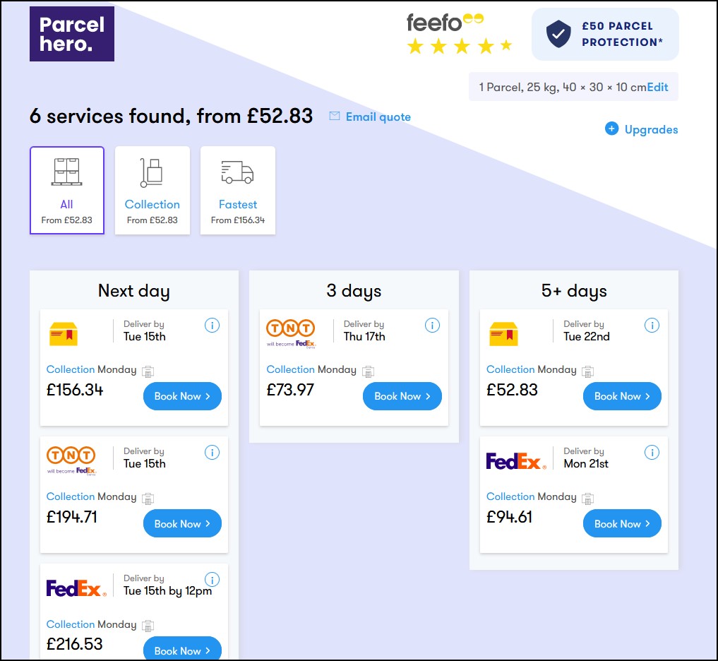

If shippng by parcel is the best option then that's fine. I have no idea how much the plate weighs I am guessing 20-25KG?
Looking at options from this end the cheapest is about £60 which is quite acceptable.
To je skvělé, děkuji.
Pokud je zásilka balíkem nejlepší volbou, je to v pořádku. Nemám ponětí, kolik váží talíř, tipuji 20-25 kg?
Když se podíváme na možnosti z tohoto konce, nejlevnější je asi 60 GBP, což je docela přijatelné.

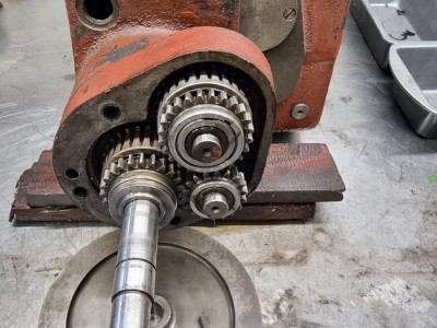

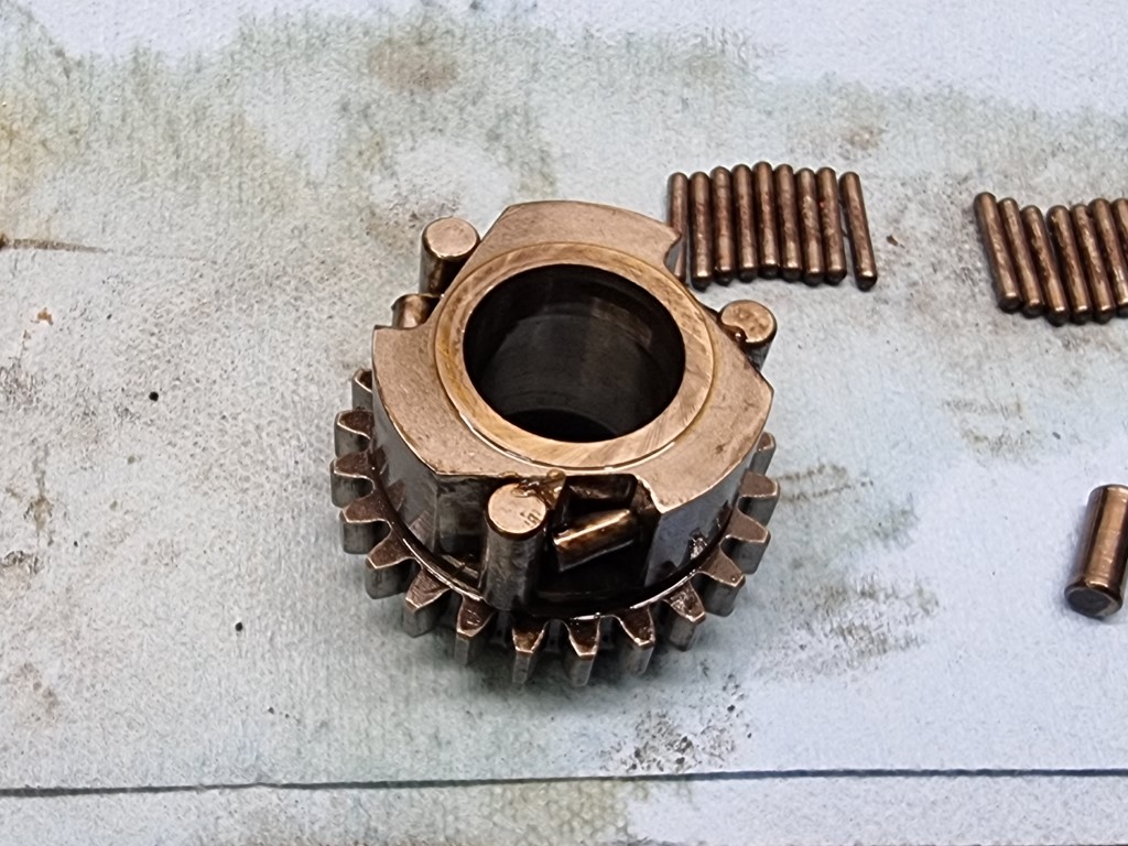

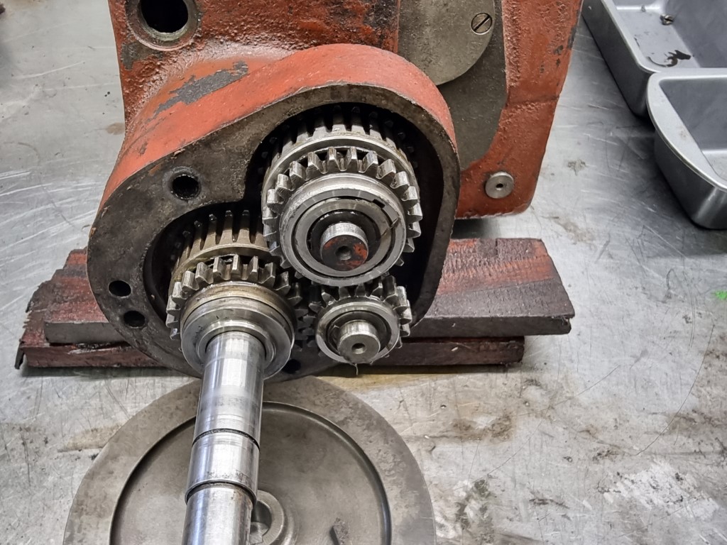

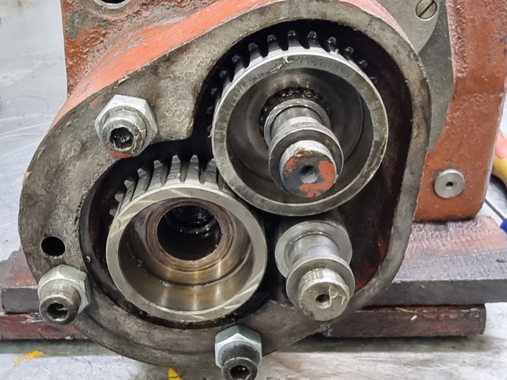

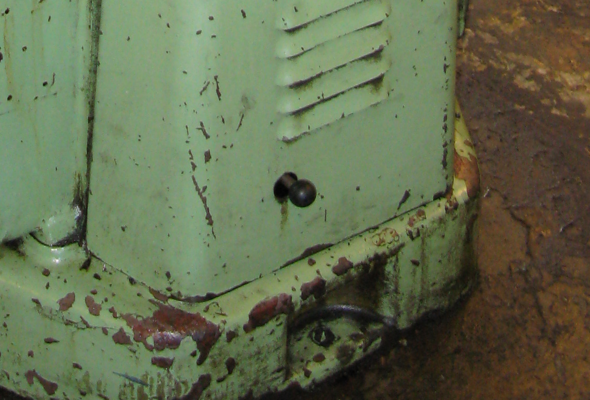

Looking at my feed gearbox it's different to some others I see photos of. Some have this control knob to reverse the gearbox feed for when the motor is running backwards
Když se podívám na moji podávací převodovku, je to jiné než u jiných, které vidím na fotografiích. Některé mají tento ovládací knoflík pro obrácení posuvu převodovky, když motor běží vzad

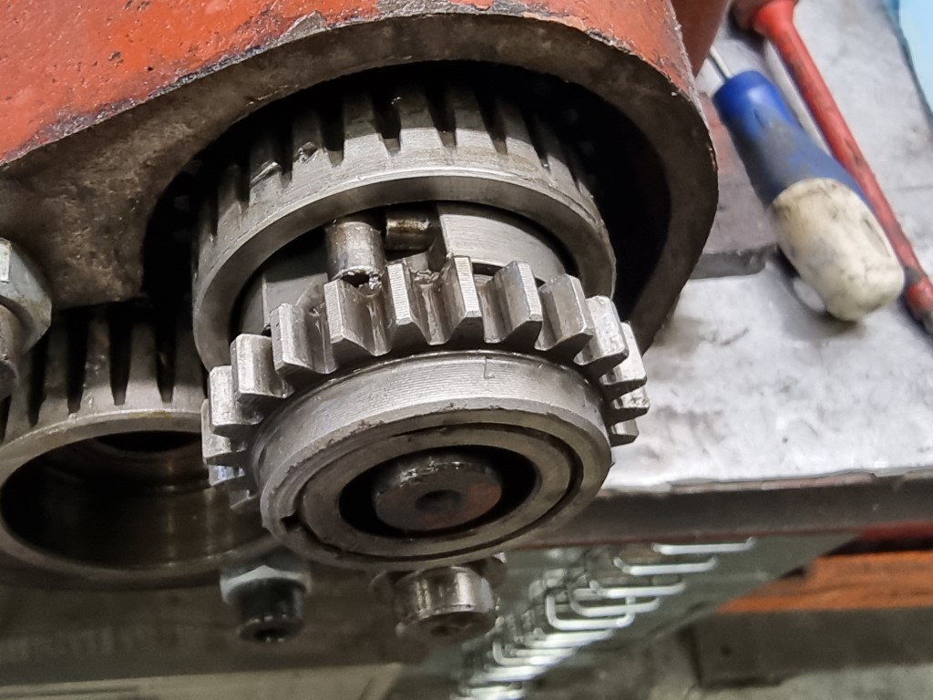

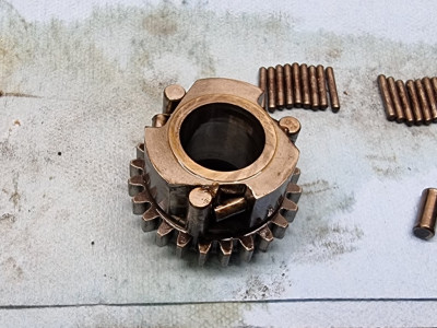

Mine has a double slipping clutch system. One clutch drives the input directly, the other through an idler so no matter which way the motor is turning, the feed gearbox always turns the correct way.
Můj má systém dvojité kluzné spojky. Jedna spojka pohání vstup přímo, druhá přes volnoběžku, takže bez ohledu na to, kterým směrem se motor otáčí, převodovka posuvu se vždy otáčí správným směrem.
No need for a control knob with this system!
U tohoto systému není potřeba žádný ovládací knoflík!

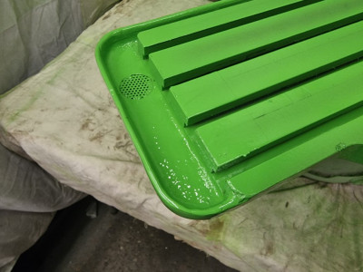

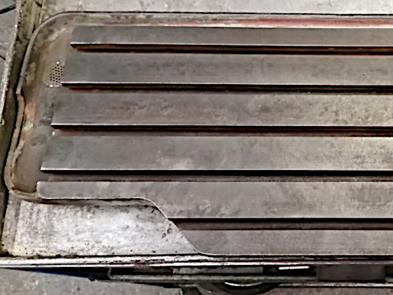

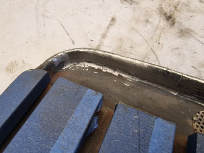

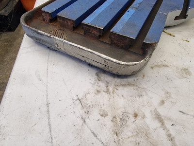

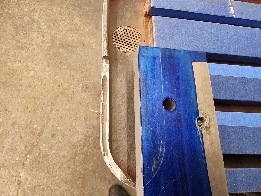

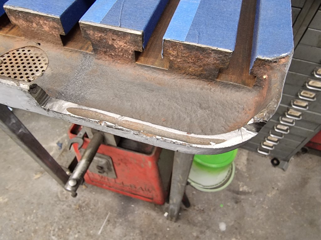

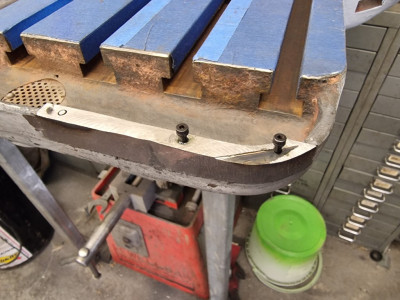

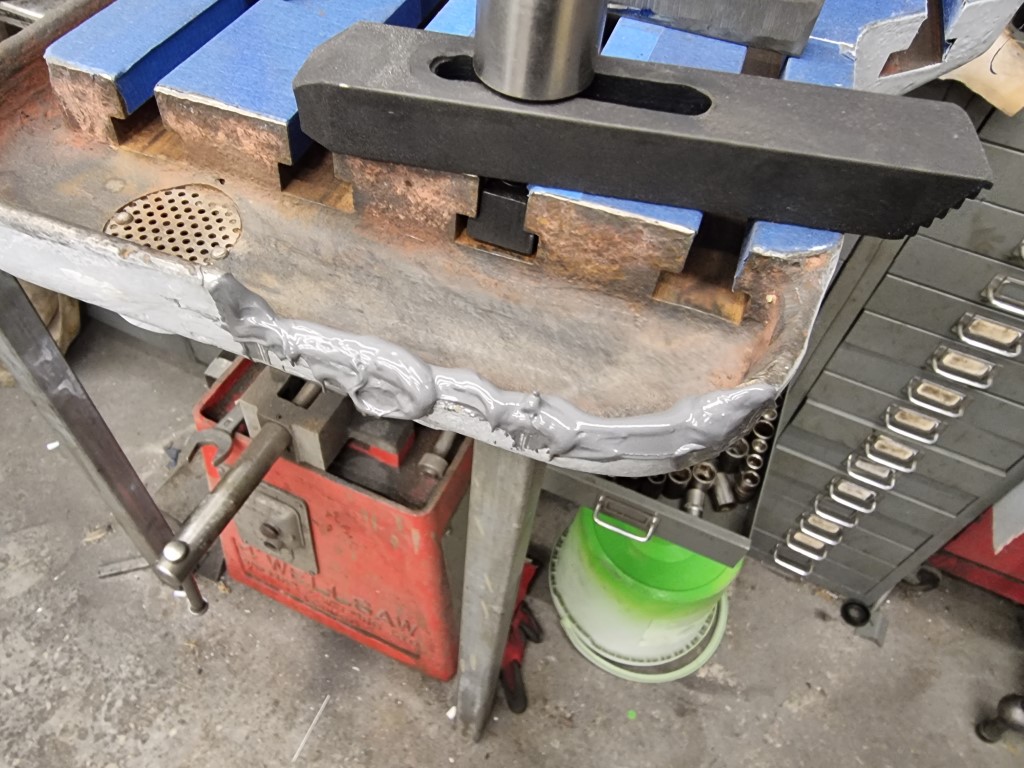

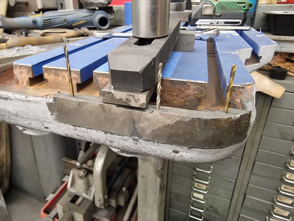

Today, I rapaired the table edge.
Dnes jsem opravil hranu stolu
Příspěvky: 5255
18. 8. 2023, 10:43
Krásná prace :!: Ale fakt ošklivý odstín zelené :lol:
Beautiful work :!: But a really ugly shade of green :lol:
