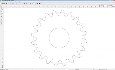

Ozubená kola generuje i tento program:
http://www.emachineshop.com/machine-sho ... ge100.html
