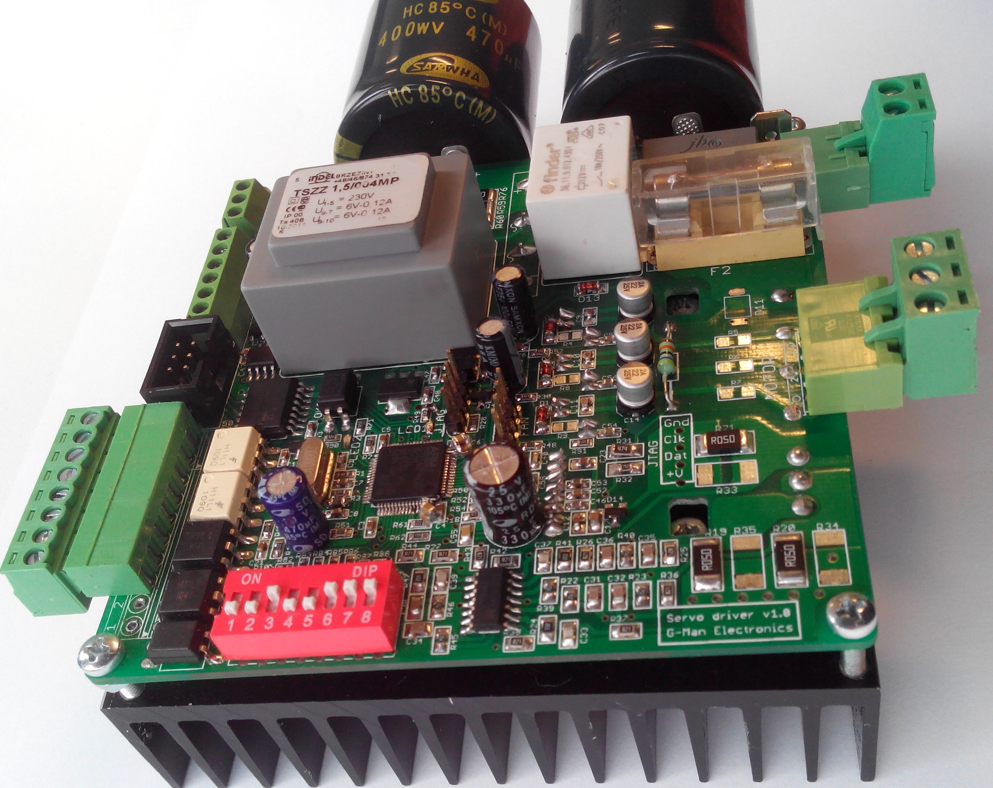

3Ph inverter, input AC 230V, max 2kW

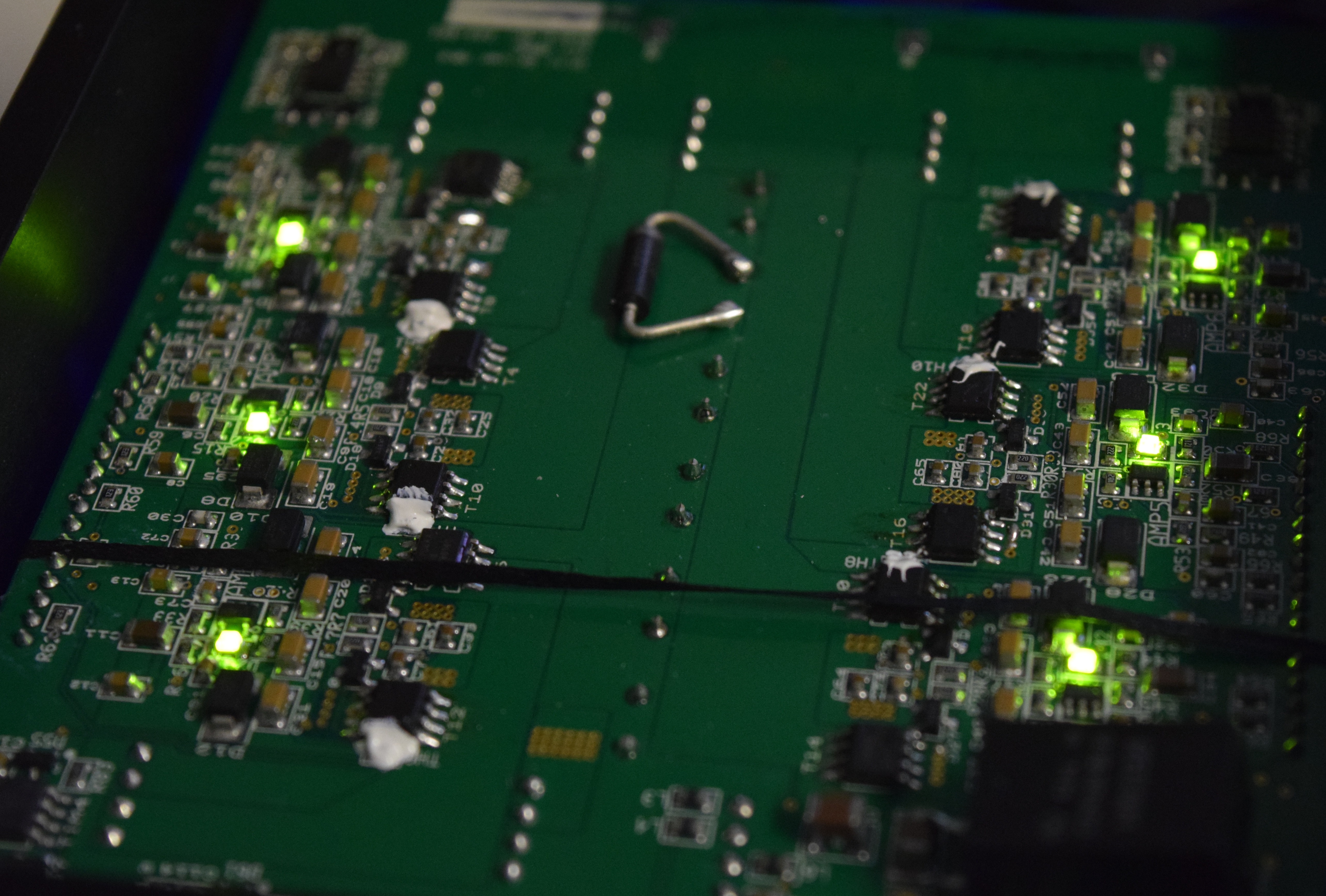

6-ch DC motor controller, 80V, 15A/Ch

Nice inverter you build there GMAN.
