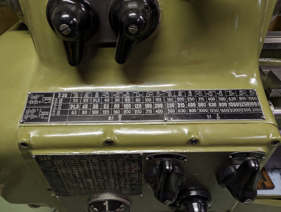

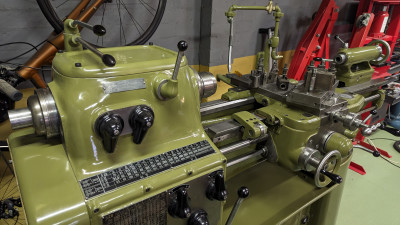

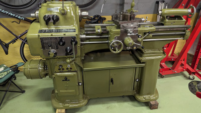

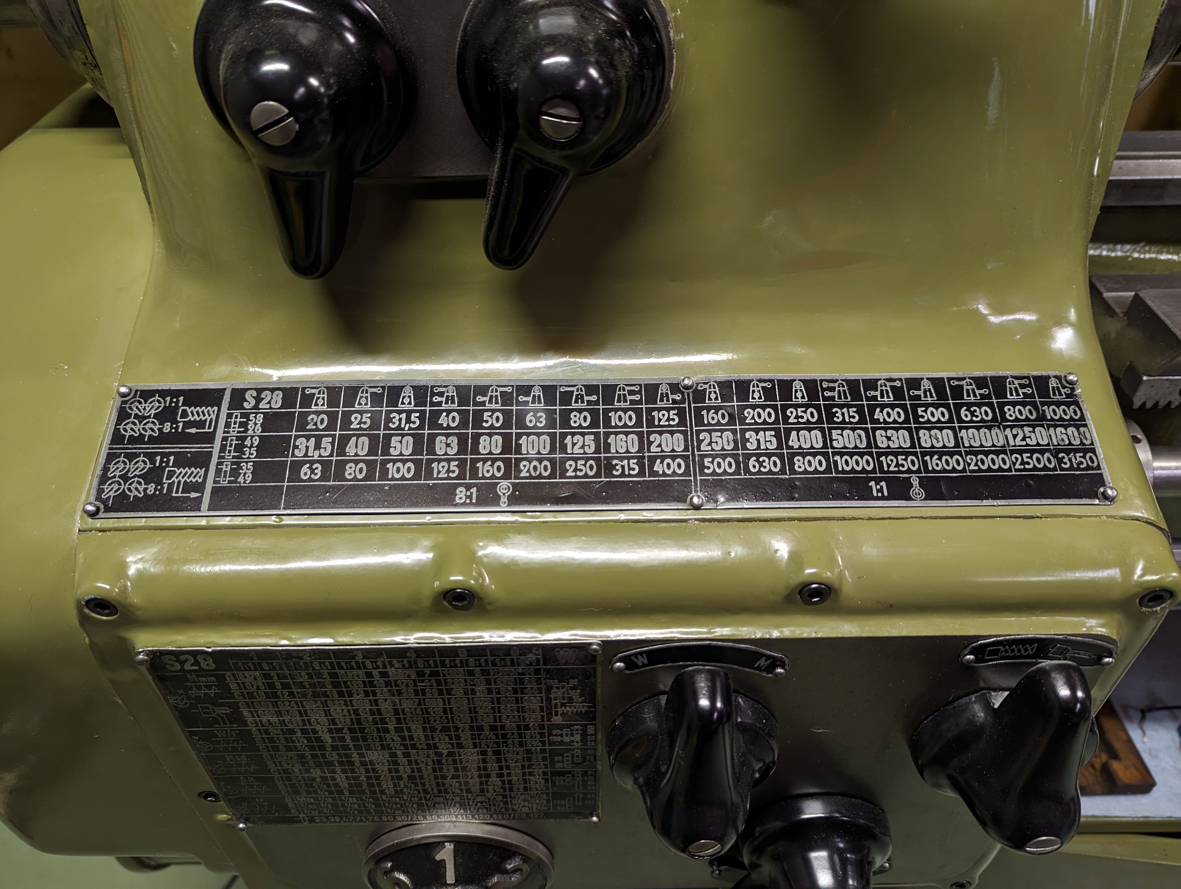

Jsem v závěrečné fázi "restaurování" S28. Níže přidám pár obrázků. Rozebral jsem ho, vyčistil a natřel a opravil, co jsem viděl, že je potřeba opravit. Dalším krokem je jeho používání a uvidíme, zda něco potřebuje opravit / renovace pak.
Nyní je vše zpět dohromady, naplnil jsem novým olejem, ale olej není čerpán. Olejové čerpadlo funguje - vyzkoušel jsem ho před rozebráním stroje. Také motor se točí správným směrem. Olej je na vodorovné čáře v průhledítku.

I am in the final stages of 'restoring' an S28. I'll add some pictures below. I have stripped cleaned and painted it and fixed what I could see needed fixing. Next step is to use it and see if anything need fixing / refurbishment then.
Now it is all back together I have filled with new oil but the oil is not being pumped. The oil pump does work - I tested it before I stripped the machine. Also, the motor is spinning in the correct direction. The oil is at the horizontal line in the sight glass.

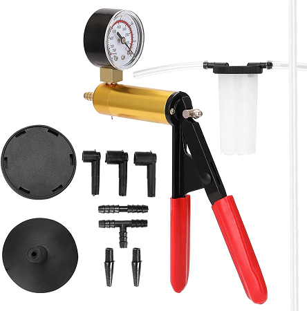

Do you have the possibility to create a vacuum at the output of the oil pump?
The easiest, in my opinion, is to use a vacuum pump to bleed the brakes on the car (something like in the picture).

I did end up resolving this last night. The pump does seem to be self priming. What I was doing wrong was running the motor too slow. I have it on a VFD and was running it at about 1/3 to 1/2 speed. I didn't want to run at full speed without oil being pumped. Kind of a "chicken and egg" situation.
I ran it faster and it starting pumping fairly quickly.
