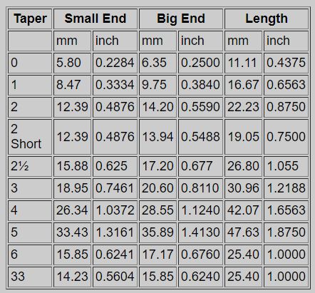

Jacobs Taper
Small End Big End Length
mm inch mm inch mm inch
6 15.85 0.6241 17.17 0.6760 25.40 1.0000
33 14.23 0.5604 15.85 0.6240 25.40 1.0000
Jsou to tyhle kužely
