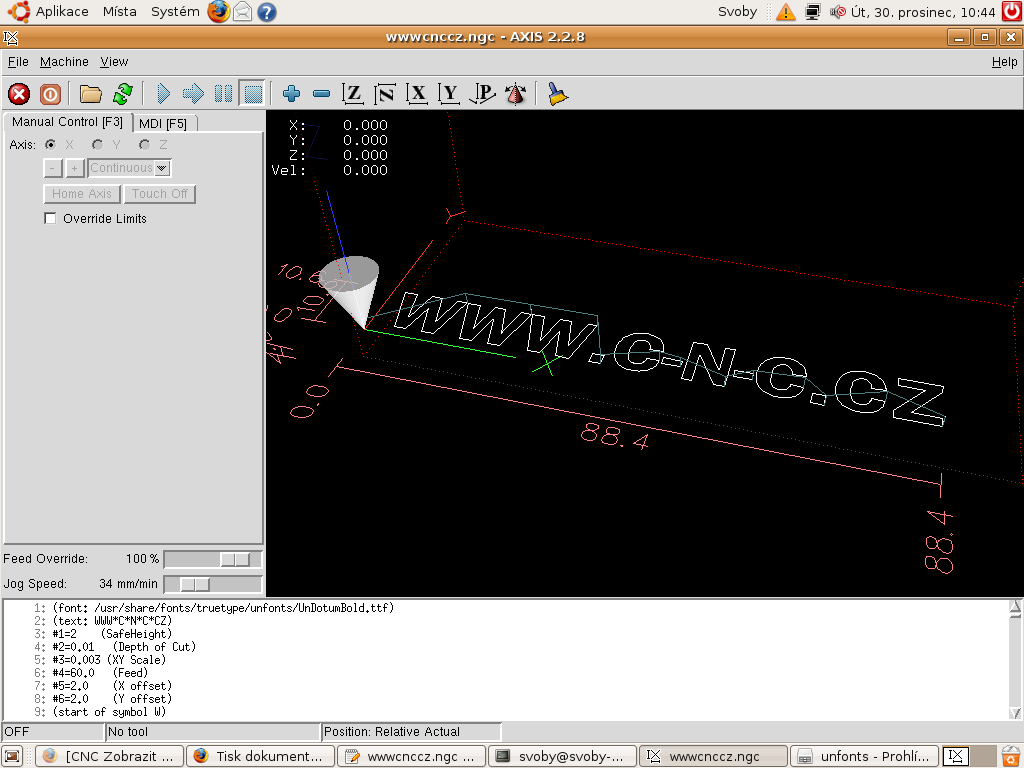

Jeste si upravite parametry jak vam to vyhovuje.
#1=2 (SafeHeight) zdvih Z-ka
#2=0.01 (Depth of Cut) hloubka frezovani
#3=0.003 (XY Scale) meritko
#4=60.0 (Feed) posuv
#5=2.0 (X offset)
#6=2.0 (Y offset)
Mozna vam nebude stacit pocet radku v terminalu. Pak staci jen v Upravit/Aktualni profil/Rolovani nastavit potrebny pocet radku.
