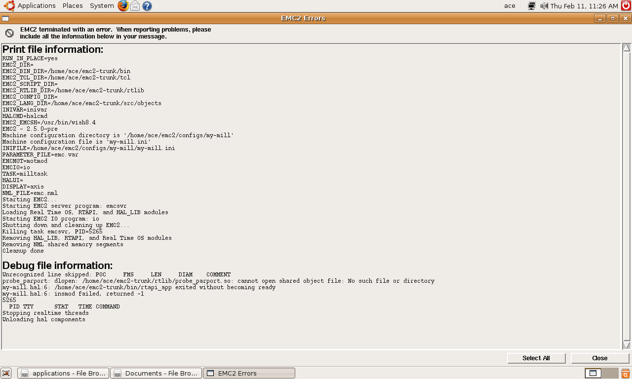

nainštaloval som si emc2ku na čiste ubuntu inštalované cez wubi ) ako simulátor bez mašinky, skúšal som zakomentovať v halle všetko podla popisu vyššie
emc nainštalovane ale nedarí sa mi to rozbehnúť
vie niekto pomôcť ako ho rozbehnúť?
v linuxe som začiatočník, viem základy, zhruba kde čo nájsť a tie bežnejšie veci.
inštalácia išla podla install.sh ( ručne zadane do konzoly, spustiť sa mi to nepodarilo )
Ubuntu 10.04 LTS - Lucid Lynx
dáta configu som použil z mašinky ktorá pracuje bez problémov..
Kód: Vybrat vše
Print file information:
RUN_IN_PLACE=no
EMC2_DIR=
EMC2_BIN_DIR=/usr/bin
EMC2_TCL_DIR=/usr/share/emc/tcl
EMC2_SCRIPT_DIR=
EMC2_RTLIB_DIR=/usr/lib/emc2/modules
EMC2_CONFIG_DIR=
EMC2_LANG_DIR=/usr/share/emc/tcl/msgs
INIVAR=inivar
HALCMD=halcmd
EMC2_EMCSH=/usr/bin/wish8.5
EMC2 - 2.4.6
Machine configuration directory is '/home/pepet/emc2/configs/zenbot1'
Machine configuration file is 'zenbot1.ini'
INIFILE=/home/pepet/emc2/configs/zenbot1/zenbot1.ini
PARAMETER_FILE=emc.var
EMCMOT=motmod
EMCIO=io
TASK=milltask
HALUI=
DISPLAY=axis
NML_FILE=emc.nml
Starting EMC2...
Starting EMC2 server program: emcsvr
Loading Real Time OS, RTAPI, and HAL_LIB modules
Starting EMC2 IO program: io
Starting EMC2 TASK program: milltask
Starting EMC2 DISPLAY program: axis
libnml/buffer/physmem.cc 143: PHYSMEM_HANDLE: Can't write 11568 bytes at offset 72 from buffer of size 10208.
libnml/cms/cms_in.cc 1383: CMS:(emcStatus) Error writing 11568 bytes to global memory at offset 273DDE0
(See libnml/cms/cms_in.cc line 1386.)
* Current Directory = /home/pepet/emc2/configs/zenbot1
* BufferName = emcStatus
* BufferType = 0
* ProcessName = emc
* Configuration File = emc.nml
* CMS Status = -3 (CMS_INTERNAL_ACCESS_ERROR: An error occured during an internal access function. )
* Recent errors repeated:
* BufferLine: B emcStatus SHMEM localhost 10240 0 0 2 16 1002 TCP=5005 xdr
* ProcessLine: P emc emcStatus LOCAL localhost W 0 1.0 0 0
* error_type = 5 (NML_INTERNAL_CMS_ERROR)
Maximum number of errors to print exceeded!
No option 'show_program' in section: 'DEFAULT'
No option 'show_rapids' in section: 'DEFAULT'
No option 'show_live_plot' in section: 'DEFAULT'
No option 'show_tool' in section: 'DEFAULT'
No option 'show_extents' in section: 'DEFAULT'
No option 'show_machine_limits' in section: 'DEFAULT'
No option 'show_machine_speed' in section: 'DEFAULT'
No option 'show_distance_to_go' in section: 'DEFAULT'
No option 'dro_large_font' in section: 'DEFAULT'
No option 'block_delete' in section: 'DEFAULT'
No option 'optional_stop' in section: 'DEFAULT'
No option 'recentfiles' in section: 'DEFAULT'
waiting for s.axes
waiting for s.axes
waiting for s.axes
waiting for s.axes
waiting for s.axes
waiting for s.axes
waiting for s.axes
waiting for s.axes
waiting for s.axes
Shutting down and cleaning up EMC2...
Killing task emcsvr, PID=17412
Killing task milltask, PID=17431
Removing HAL_LIB, RTAPI, and Real Time OS modules
Removing NML shared memory segments
Cleanup done
Debug file information:
Unrecognized line skipped: POC FMS LEN DIAM COMMENT
A configuration error is preventing emc2 from starting.
More information may be available when running from a terminal.
17412
PID TTY STAT TIME COMMAND
17431
Stopping realtime threads
Unloading hal components

Podle mě to bez RTAI jádra nepoběží.

Podle mne mu RTAI bezi.
Spis sem nepochopil , proc to instalujes jako simulator. Proc pouzivas instalaci starych balicku, ta verze urcite neni stabilni , byl to prechod mezi 8.04 a 10.04. Verze 10.04 je dnes uz LTS.
PS: stahni si live distro a nainstaluj ho. (nainstalujes to v sedmi krocich po zasunuti do CD mechaniky)

problém je že je a musí to byť inštalované cez WUBI.Radek-B píše:Podle mne mu RTAI bezi.
http://www.linuxcnc.org/lucid/ubuntu-10 ... 1-i386.iso
RADEK
Môj super extra tutifruti najbežnejší PC nieje schopný nainštalovať a prevádzkovať akýkoľvek Linux bežnou inštaláciou bez toho aby nepoškodil Win ktorý tam mám.
(ono raid a iné komponenty slúžiace k inej činnosti máju po inštalácii Linuxu problém a win potom jednoducho nejde )
Skúšal som to ja niekoľko mesiacov a aj pár známych čo Lunex používajú.
Takže štandardnou cestou to nejde, Nahodil som wubi a nainštalovať live-cd (jeho img a iso som skúšal podla návodu umiestniť do adresára, skúšal som vytvoriť aj tie MDsum súbory - z originál na EMC LC ale wubi ho nevidí, takže ani tadiaľ cesta nevedie )
Takže ani ak to nejde.
Nainštaloval som Ubuntu a na neho podľa návodu EMC
1. skúšal som niekoľko návodov, ( jasne bud je niečo zastaralé alebo nepresné alebo na iný systém a kompatibilitu lama neporieši )
2. skúšal som inštalovať z 10ky Live cd emc, hm zdroj pridal, ale inštalacia nezačala kvôli nejakej fatal eror.
