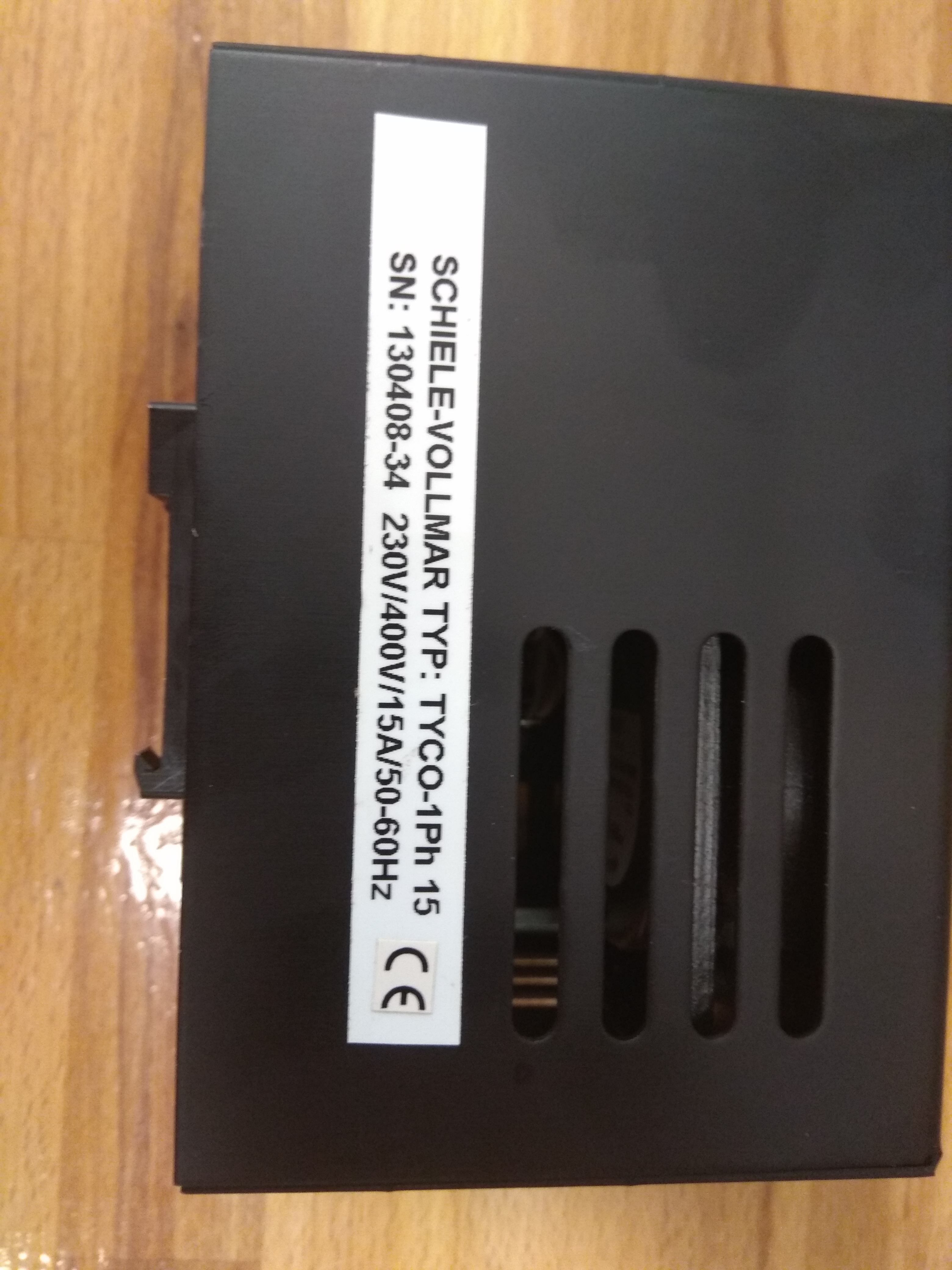

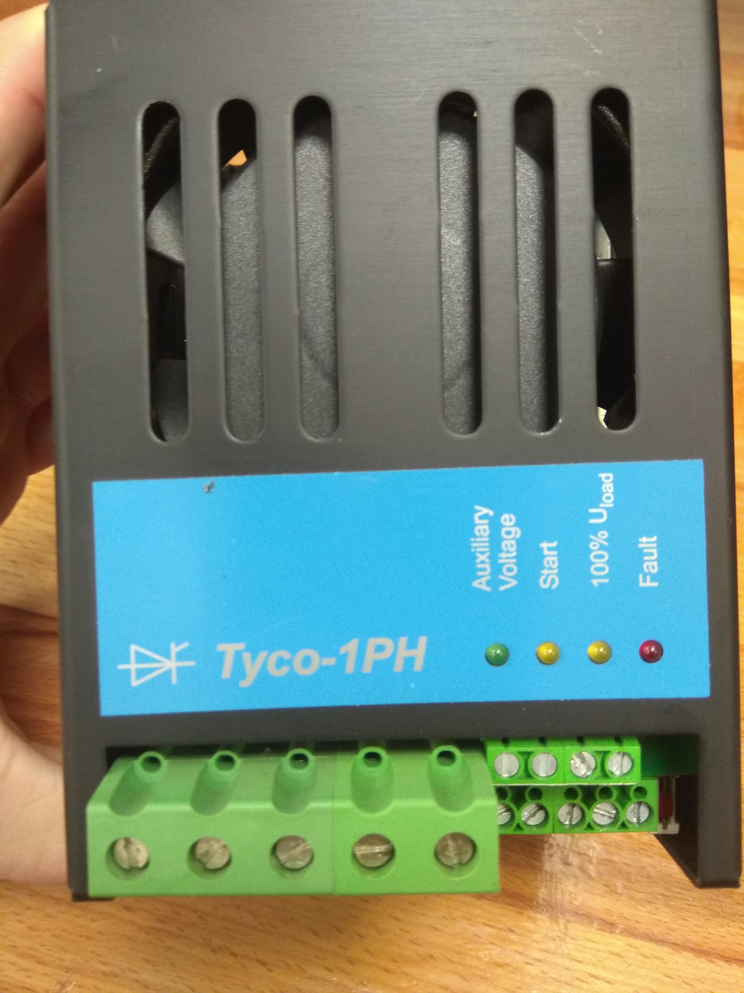

TYCO 1Ph - 15
Pouzivany velmy malo, nyni jiz nevyuziju.

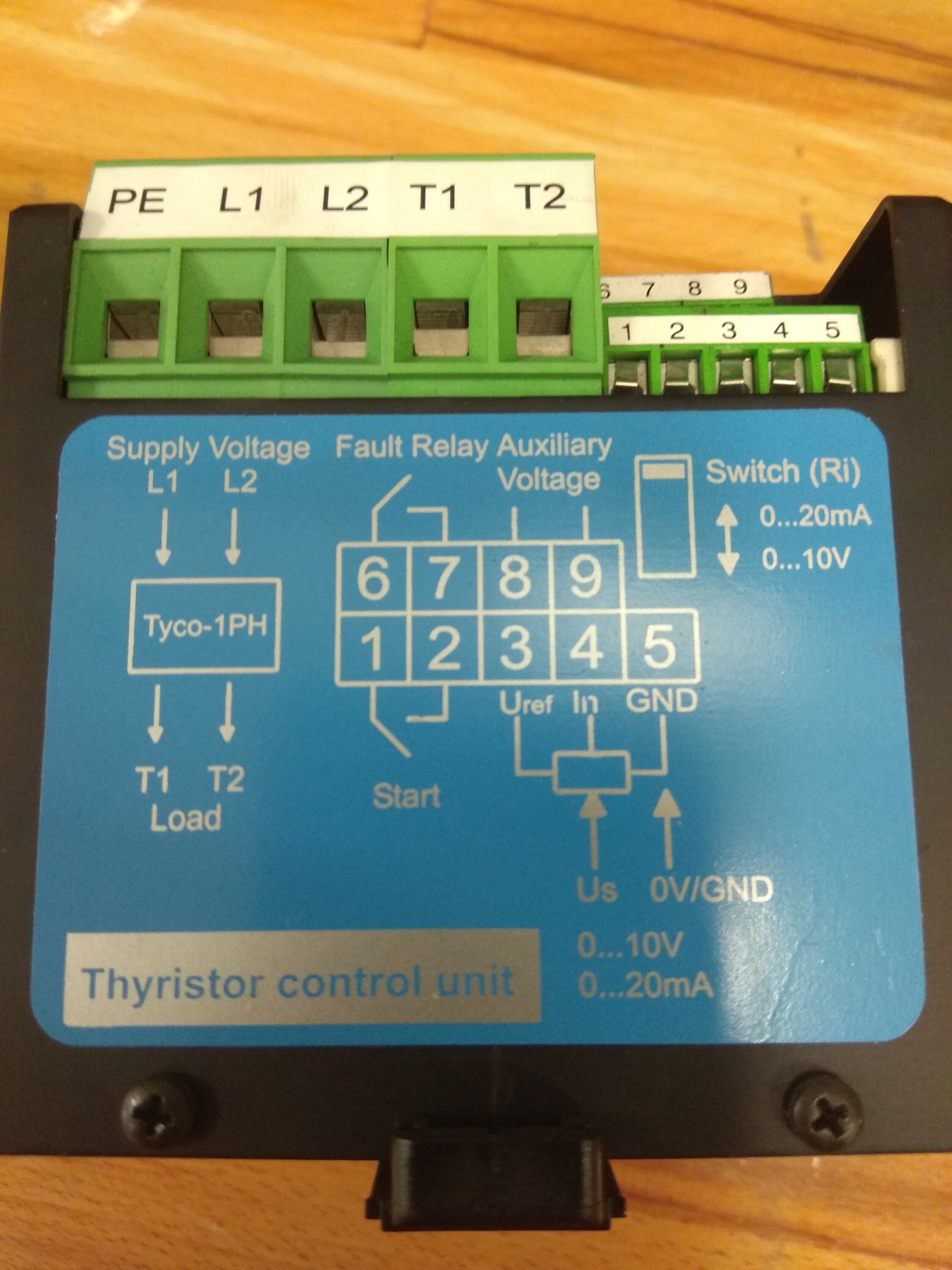

Output: fault message: terminals 6, 7, load: 2A,
230V AC, AC1
Power connections: L1 and L2 input voltage
T1 and T2 output voltage

Inputs: 0...10V, 0...20mA or potentiometer
(2,5...47kOhm), switchable input-
impedance: 500 Ohm, 50kOhm
