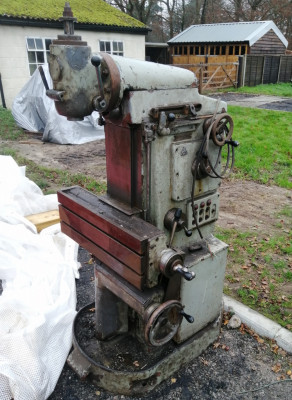

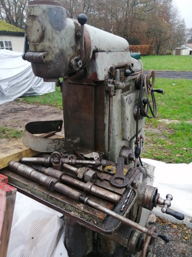

Here is my TOS FN22 milling machine which I have bought recently and will treat to a full rebuild. It came from a steam museum where it was kept for a long time but seldom used. They have replaced all of their maintenance equipment and sold off the old stuff, including this one.
The machine has come to me including most of the attachments that should normally be included except for the rotary table. However, some of the attachments have not been used for a long time and require servicing before they can be used, and some of them have parts missing.
I have the machine fitted with the standard (gear driven) vertical head. Apart from being very dirty this appears to be in reasonable condition.

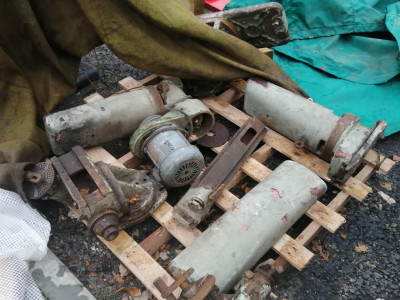

I also have:
Slotting head
High-speed head
Horizontal over-arm and arbors
Fixed table
Tilting table
Indexing attachment

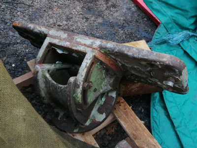

3. My indexing attachment comes with a cast iron support arm which is fitted with a long gib. This gib is missing. I can make a new one but I would rather buy one if I can. If I have to make one I would appreciate it if someone could give me the overall length and thickness at each end. The small gib is present but it's non-original. If I could get the dimensions for that it would be great too.

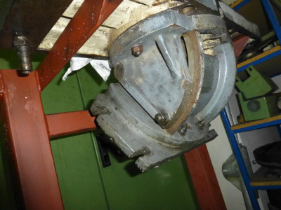

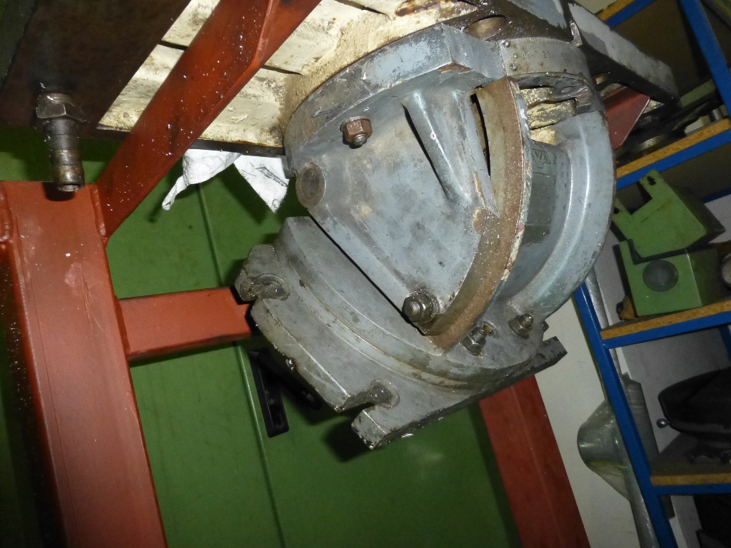

4. My biggest problem is that I am missing the base plate for the rotating table. As you can see it is not attached to the table in this pic and it did not come separately with the machine.
I don't think that I can expect to find this part so I am almost resigned to having one cast and machined. The biggest hurdle to that is knowing the size and shape of the various features on the part top and bottom. I can get the shape of the round top section from it's mating part which I have and I can get the general arrangement from images online, but what I really would like is a good face-on photo of both sides and if possible, a sketch/tracing/rubbing from the bottom face most especially.
Is there someone on the forum who can help me with this? If so I can give the foundry guy enough detail to make a pattern for casting.

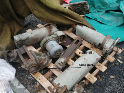

taky koukam uz 15 minut co mu vlasne chybi..
na fotkach ma oba stoly.. pokud tedy neni na prvni fotce ten otocny -TZ chybi mu pevny
dale schani asi klinky na maly tram.-
a nevidim tam operne lozisko na velky tram a klinky (ty se pouzivaji z jineho tramu -obrazecka,horizontalni hlava)
a kryt vrchni na frezku

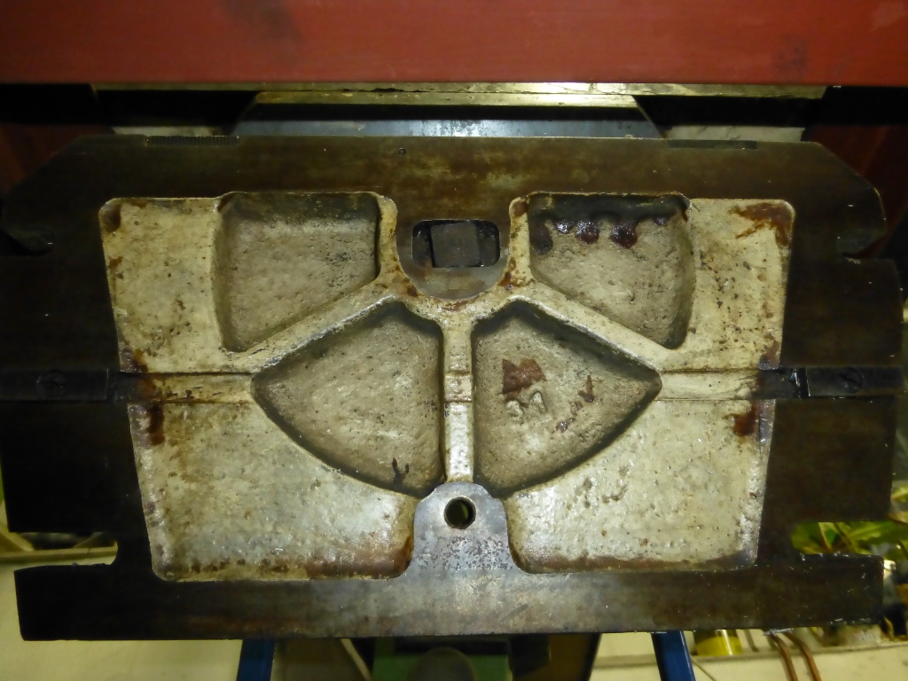

The part I am missing is the fixing plate for the tilting table where it bolts to the console. I have highlighted it in this pic.
If I can find that part I would be very happy but otherwise I will have to get one made.

ssmak3050 píše: 1. 12. 2021, 10:20 taky koukam uz 15 minut co mu vlasne chybi..
no odkaz na nake veci -foto:
https://ssmak.rajce.idnes.cz/?sort=albumName&order=Asc

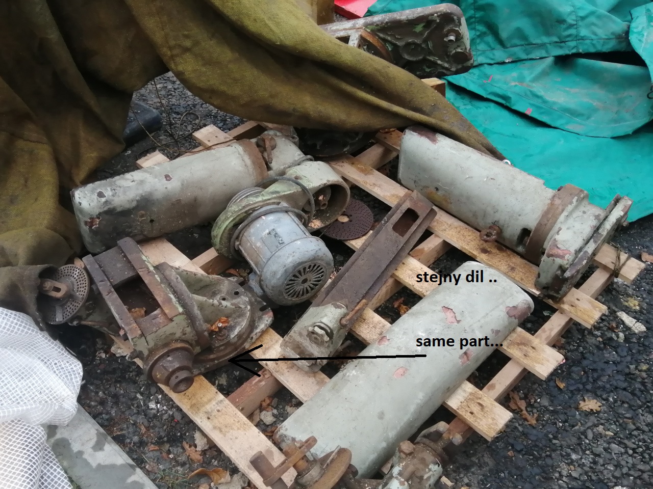

ssmak3050 the two gib wedges I am missing are the ones shown in your photo here:
https://ssmak.rajce.idnes.cz/A1_Delicka ... 1339341387
I can make these, but it would be very nice if I could get the measurements off them.

I already had that idea. Sadly the mount for the indexing attachment is about 30% smaller than the mount for the tilting table :(
Už jsem ten nápad měl. Je smutné, že držák pro indexovací nástavec je asi o 30 % menší než držák pro sklopný stůl

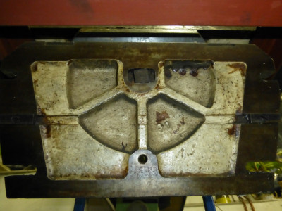

Please, is there anybody out there who can help me with some photos and dimensions of this part? I am going to get one made if I can only get the info of the basic shape and dimensions of the slots, keys, outside dimensions etc.
Prosím, je tu někdo, kdo by mi pomohl s fotkami a rozměry tohoto dílu? Nechám si jeden vyrobit, pokud mohu získat pouze informace o základním tvaru a rozměrech slotů, klíčů, vnějších rozměrů atd.

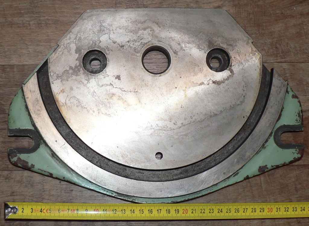

TOS FN22 je kopie Deckel FP1.
Lépe koupit stůl pro FP1, Macmon, Prvomajska, etc..
Rozměry těchto klonů jsou identické.

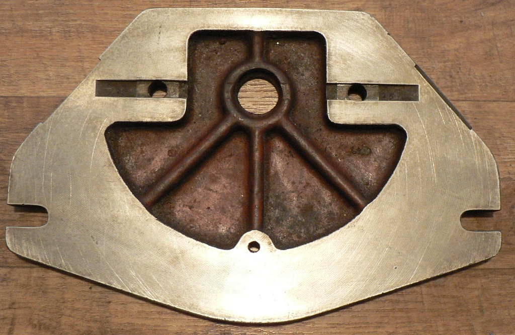

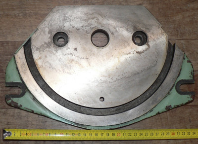

5. 12. 2021, 7:44
Radek335
Příspěvky: 416
Registrován: 2. 2. 2017, 9:05
Bydliště: Hamry nad Sázavou
5. 12. 2021, 8:23
FA3V_V20_CZ1337G_Pilous ARG130_Kowax GeniMig 250LCD_Orlík 2JSK75

edyss1 píše: 5. 12. 2021, 7:44.

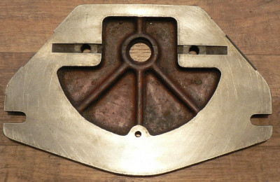

That is perfect edyss1, thank you.
I can now make my pattern to have one cast.
Radek335 thank you also, I was getting ready to make an offer for the mount plate and scrap the rest to reduce shipping costs. Making one will still be cheaper however.
doplneny rozmery :)
https://ssmak.rajce.idnes.cz/A1_Delicka ... 1518042328

ssmak3050 píše: 7. 12. 2021, 8:33 doplneny rozmery :)
Thank you for the dimensions. They will give me a good starting point to cut a rough blank for scraping a new gib.

Příspěvky: 7451

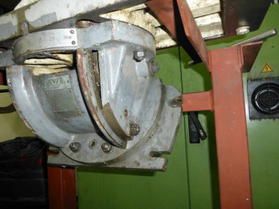

9. 12. 2021, 8:32
Hi Peter,

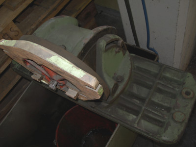

there is some photo of base of tilting table from Polish mill Avia FNC25
it is clone of Deckel too
it help You maybe
