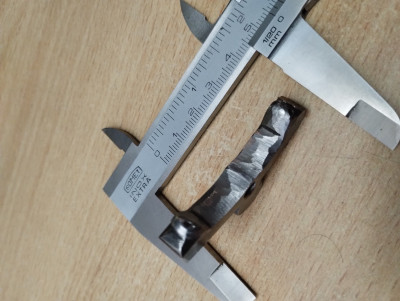

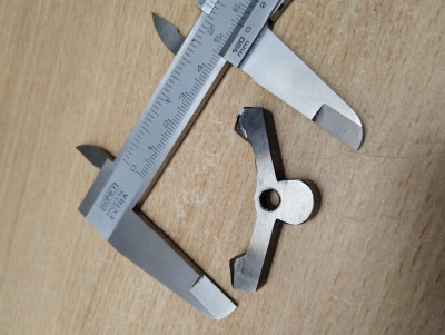

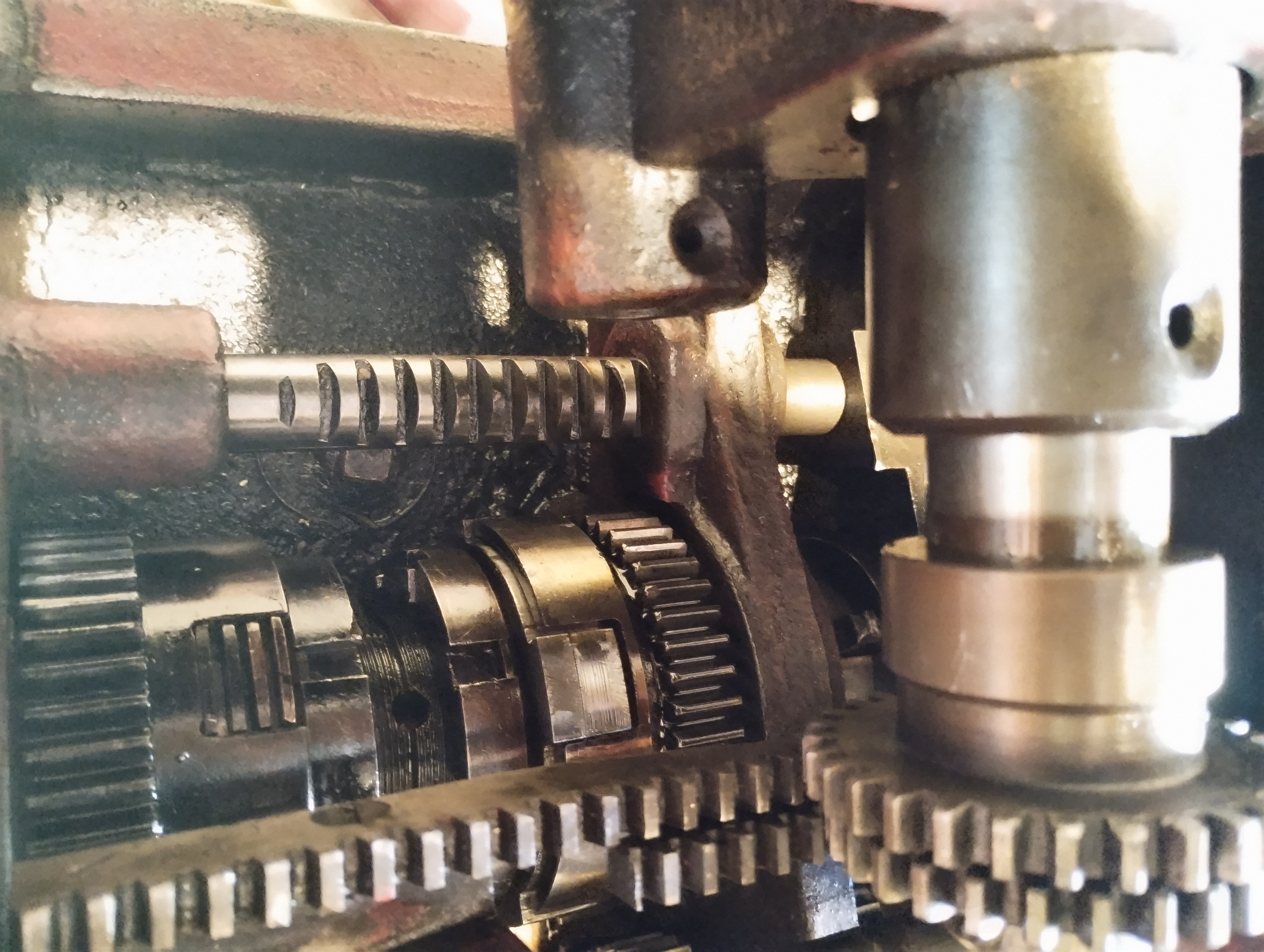

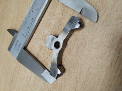

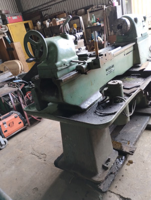

Ahoj mi name Is Javier Parica z Argentiny.A few months ago I bought a lathe Cindelmet T5, exactly the same like SN20, I thinks was produced by license or just copy. I'm fixing some trouble on clutch, was locked and machine work only in one way. So my idea is to keep as original with the confortable clutch. Im looking for spušť (triggers) some image or measures better for make it. I am also a fan of Jawa and Čezet a whole Čech industry. There are also in Argentina TOS and MAS machines.

Hello "javijawa". The clutch is adjustable. After releasing a catch on clutch nut, you can rotate the clutch nut and adjust a suitable gap. After adjusting you have to fasten the catch on it (safety lock).
Plates in the clutch should be in a good condition, no scratches and grooves, a good flatness.

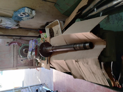

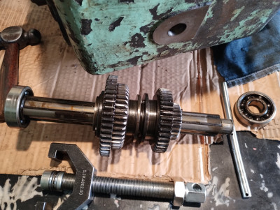

Hi, thanks a lot for the manual. Now I'm looking for some measure or geometry, or just a pic of spojky spoušť , i don't know how it is called in Czech exactly, triggers or "gatillos" in Spanish for clutch lock, I can't even find like a spare part, I know they are old machines. Maybe somebody knew something, it would be great help.
Moc děkují!
I leave some pics of how they look, had a bad fix
