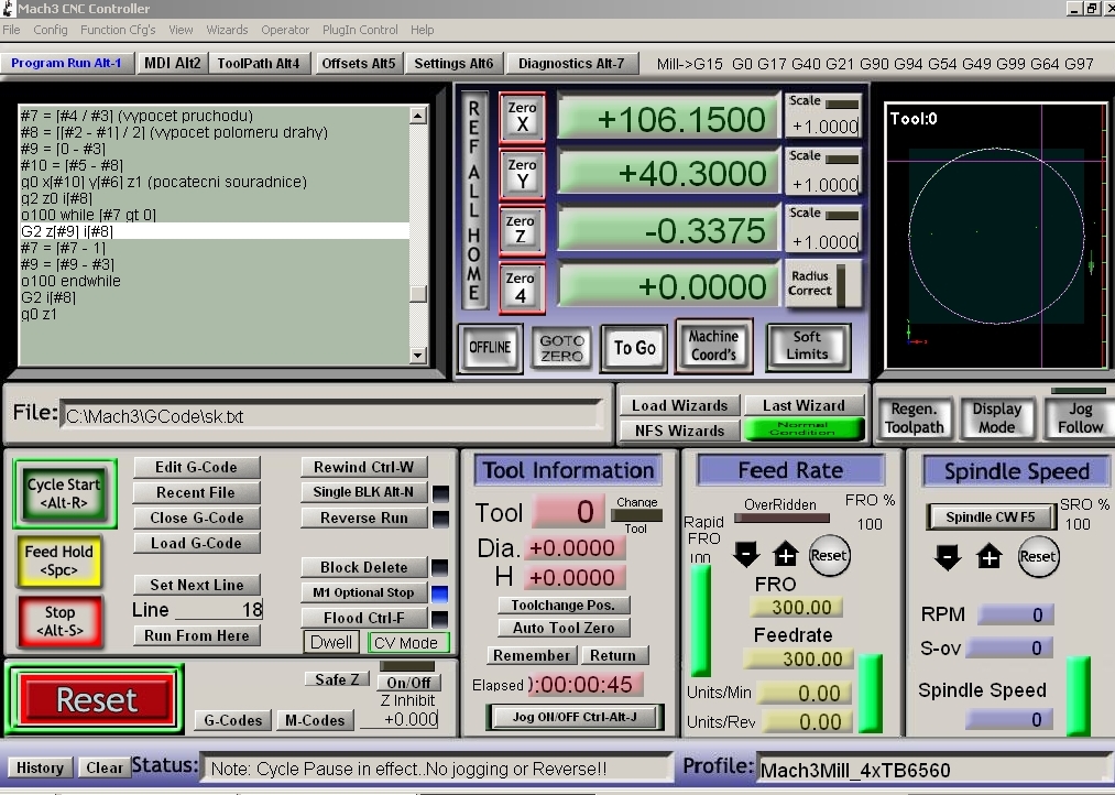

Docela by mě zajímalo, jestli mach zpracuje todle :
(vyrezavani diry-obrys)
G17 G21 G40 G49 G54 G80 G90 G94
(vyplnit --------)
f300
#1 = 6 (prumer nastroje)
#2 = 30 (prumer diry)
#3 = 1 (prirustek v z ose)
#4 = 10 (hloubka diry)
#5 = 100 (stred-souradnice x)
#6 = 30 (stred-souradnice y)
(vypocita se z vyplneneho-------)
#7 = [#4 / #3] (vypocet pruchodu)
#8 = [[#2 - #1] / 2] (vypocet polomeru drahy)
#9 = [0 - #3]
#10 = [#5 - #8]
g0 x[#10] y[#6] z1 (pocatecni souradnice)
g2 z0 i[#8]
o100 while [#7 gt 0]
G2 z[#9] i[#8]
#7 = [#7 - 1]
#9 = [#9 - #3]
o100 endwhile
G2 i[#8]
g0 z1
mě to v pohodě funguje pod linuxcnc :idea:

8. 6. 2012, 9:53
Super-dik za prubnutí 8)
