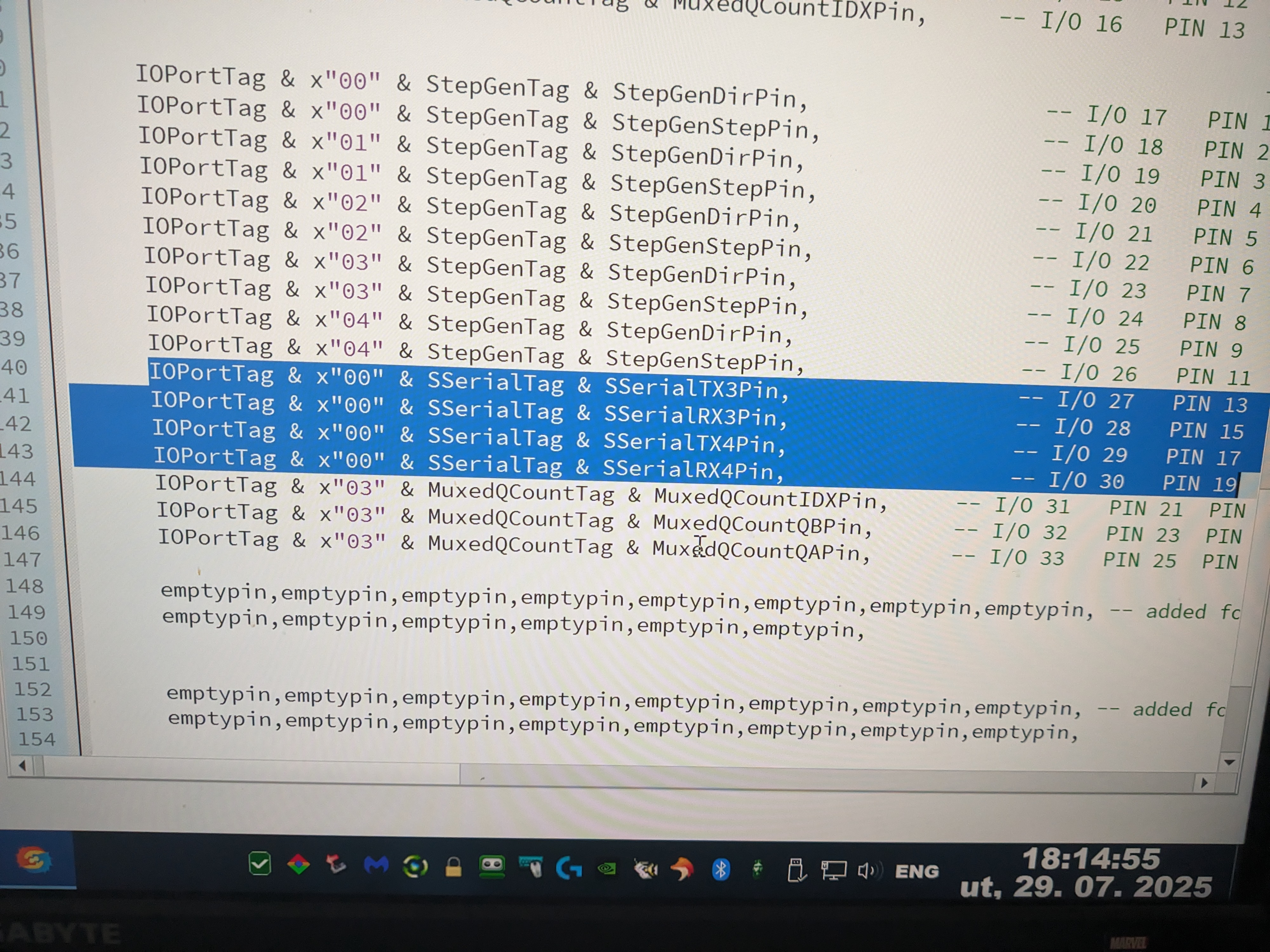

asi vadny firmware pro mesa 7i92, poradi nekdo?
ucf subor -to asi nebude co hladas
PIN_7I77_7I76_34 tam je zaujimave, ze 2-x sserial ma rovnake oznacenie (adresa ?) 00

no to prave asi bude ten problem
protoze tam maji byt tri nebo dokonce 4 kanaly ted nevim jiste
ale 7i77 ma jeden kanal na analog out a dalsi na IO piny a pak je tam jeste jeden sserial ven na dalsi zarizeni
inak som pozeral tvoju konfiguraciu v PNCCONFIG a ma to iba 1 serial
(a 2 kanaly.. neviem ako to mysleli) sserial_port_0=21xxxxxx The first digit (2) selects the software mode from the 7i76e itself,The second digit (1) selects the software mode of the connected SSerial device
cize skus konfigurovat v PNCConfig ..

ten sserial na 21xxx jsem uz zkousel driv
ve vypisu linuxcnc je toto:
hm2_eth: discovered 7I92T
hm2/hm2_7i92.0: Low Level init 0.15
hm2/hm2_7i92.0: Smart Serial Firmware Version 43
hm2/hm2_7i92.0: 34 I/O Pins used:

potom je tu vypis mesaflash readhmid:
Module: SSerial
There are 1 of SSerial in configuration
Version: 0
Registers: 6
BaseAddress: 5B00
ClockFrequency: 100.000 MHz
Register Stride: 256 bytes
Instance Stride: 64 bytes

Configuration pin-out:
IO Connections for P2
DB25 pin# I/O Pri. func Sec. func Chan Sec. Pin func Sec. Pin Dir
1 0 IOPort SSerial 0 TXEn2 (Out)
14 1 IOPort SSerial 0 TXData2 (Out)
2 2 IOPort SSerial 0 RXData2 (In)
15 3 IOPort SSerial 0 TXData1 (Out)
3 4 IOPort SSerial 0 RXData1 (In)
16 5 IOPort SSerial 0 TXData0 (Out)
4 6 IOPort SSerial 0 RXData0 (In)
17 7 IOPort MuxedQCountSel 0 MuxSel0 (Out)
5 8 IOPort MuxedQCount 0 MuxQ-A (In)
6 9 IOPort MuxedQCount 0 MuxQ-B (In)
7 10 IOPort MuxedQCount 0 MuxQ-IDX (In)
8 11 IOPort MuxedQCount 1 MuxQ-A (In)
9 12 IOPort MuxedQCount 1 MuxQ-B (In)
10 13 IOPort MuxedQCount 1 MuxQ-IDX (In)
11 14 IOPort MuxedQCount 2 MuxQ-A (In)
12 15 IOPort MuxedQCount 2 MuxQ-B (In)
13 16 IOPort MuxedQCount 2 MuxQ-IDX (In)
IO Connections for P1
1 17 IOPort StepGen 0 Dir/Table2 (Out)
14 18 IOPort StepGen 0 Step/Table1 (Out)
2 19 IOPort StepGen 1 Dir/Table2 (Out)
15 20 IOPort StepGen 1 Step/Table1 (Out)
3 21 IOPort StepGen 2 Dir/Table2 (Out)
16 22 IOPort StepGen 2 Step/Table1 (Out)
4 23 IOPort StepGen 3 Dir/Table2 (Out)
17 24 IOPort StepGen 3 Step/Table1 (Out)
5 25 IOPort StepGen 4 Dir/Table2 (Out)
6 26 IOPort StepGen 4 Step/Table1 (Out)
7 27 IOPort SSerial 0 TXData3 (Out)
8 28 IOPort SSerial 0 RXData3 (In)
9 29 IOPort SSerial 0 TXData4 (Out)
10 30 IOPort SSerial 0 RXData4 (In)
11 31 IOPort MuxedQCount 3 MuxQ-IDX (In)
12 32 IOPort MuxedQCount 3 MuxQ-B (In)
13 33 IOPort MuxedQCount 3 MuxQ-A (In)
prijde mi to ze se nedeje spravne detekce toho slave
hadam chybu ve firmware protoze samostatne s jinym firmwarem to jede
ale muze to byt cokoli
nemuzu najit seriozni popis toho konfiguracniho registru pro sserial

ja tu kartu 7i92 nepoznam, ale v manuali je :
7I77_7I76D is a configuration intended to work with
a 7I77 six axis analog servodaughtercard on P2
a 7I76 daughtercard on P1
ak su tie P1,P2 identicke, ci ich nemas prehodene...

karty mam dle popisku spravne
a kdyz je na zkousku prohodim tak to nefunguje uz vubec tj. nenajde to sserial ani na te 7i76 karte
coz predtim naslo
edit
nasel jsem:
loadrt hm2_eth board_ip="192.168.1.121" config="num_encoders=6 num_pwmgens=0 num_stepgens=5 sserial_port_0=00000001 sserial_port_1=00000001"
This will enable all features of both the 7i77 and 7i76 cards.
po tomto to ale napise tohle:
hm2/hm2_7i92.0: num_sserials references 2 instances, but only 1 are available, not loading driver
hm2/hm2_7i92.0: failed to parse Module Descriptor 5
board fails HM2 registration
coz predtim naslo
edit
nasel jsem:

tak mame rozuzleni
pri vsech tech testech jsem vyzkousel vsechny mozne kombinace
prehraval jsem si to dnes v hlave a zjistil jsem ze si nejsem jisty prohozenim kabelu
novy kabel potvrdil ze ty kombinace nebyli uplne vsechny. Bylo to prave v tom jednom kabelu.
Normalne krimpovany na plochou ksandu a je vadny.
kazdopadne dekuji vsem za podnety
